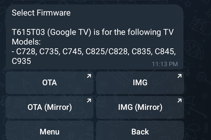

V562 is also for the C835
Yes, you can install it because the C835 has the same T615T03 platform, as does any C825 delivered in 2022 with Google TV, but TCL intended it for the 2023 models, C745 and C845.
Interpreting Telegram:
New TCL T615T03 platform Google TV Update available in V562.
TV models ....C745 & C845....
(C735 & C835 & C935).......(C728 & C825)
V8-T615T03-LF1V562.000747
C745 and C845 are not in parentheses, indicating V562 is intended for these models. C735, C835, C935, C728 and C825 are in parentheses so V562 can be installed on these models but they may or may not get all of the functionality of that firmware. So far it seems that V562 works quire well on C835 sets, as you attest.
