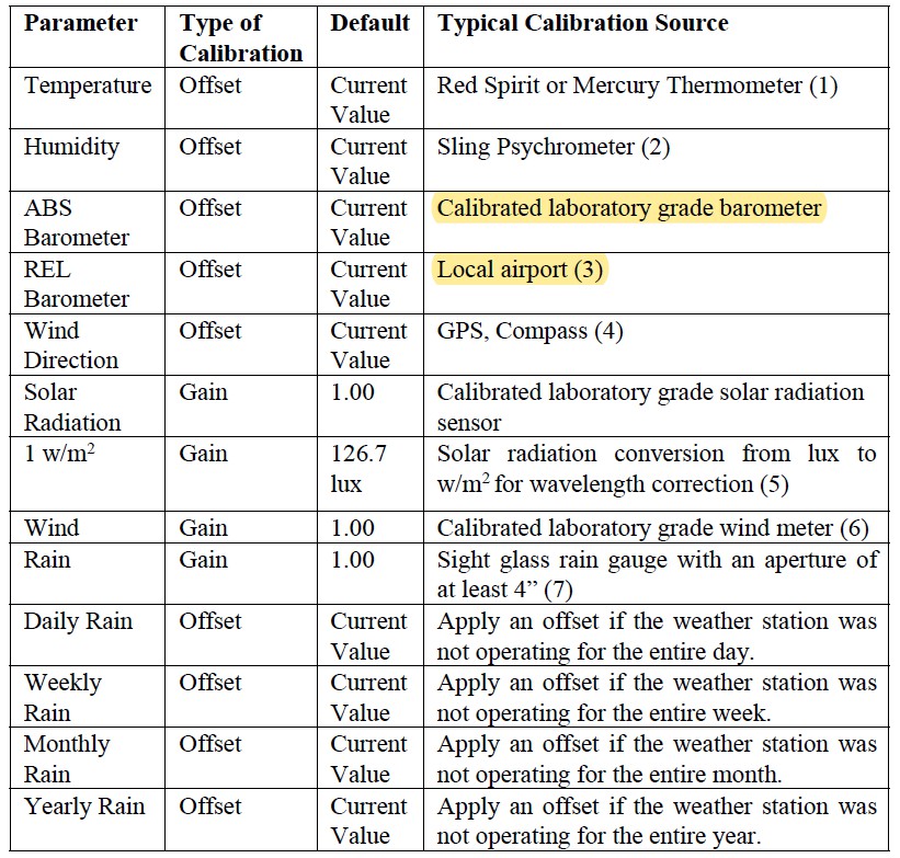

What do you wish to calibrate?
I was thinking of doing the rain sensor. The manual doesn’t say what to do. Just how to adjust.
https://app.box.com/s/aqr83nxeg68rpe1fpnqpvs6wch6l10xu (pdf)
You need a couple of marbles and an accurate ml measure,

You actually are not adjusting the sensors themselves just +/- the reading in the console depending if it is reading high or low. If you run out of power in the console it defaults to all zeros and you have to do it again.

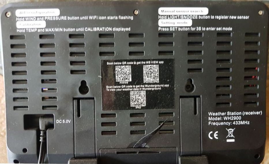

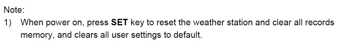

WH2900 console has batteries.
To reset the console the batteries must be removed.
This manual snip would indicate that settings are not lost unless you hold set key at power on.
https://i.postimg.cc/fRgXscrr/IMG-2944.jpg
Note:
1) When power on, press SET key to reset the weather station and clear all records
memory, and clears all user settings to default.

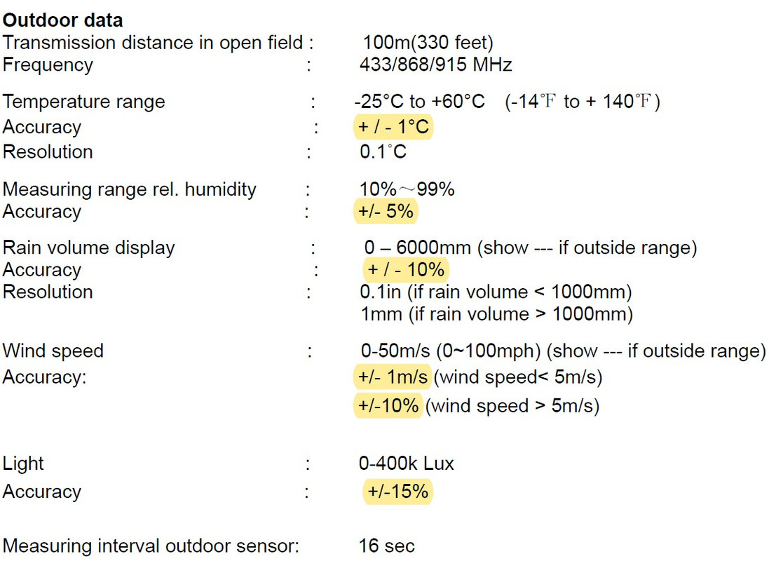

WH2900 accuracy (per manual)
The HP2551 does it have batteries in the console?
Nope. No batteries in the console. It has 16MB of internal memory. Around 2Mb is taken up by the firmware and a config record no doubt. The remainder is there to record and store the weather records, which you can then export to excel via the SD card.
I have updated the firmware twice on mine already and had numerous power outages. It did not lose any of the records or user configurations tweaks. I expect it has not lost my calibration settings either but am not at the unit just now so cannot check.
I am only going on what my WH2900 console did when there was a power outage and the batteries carked it.
When the power came back on it was completely reset. When I came home, I had to add all the calibration adjustments, date etc again.
Didnt have to add the wifi though, because you could see on WU where the power went out and then the uncalibrated settings start up after the power came back on.

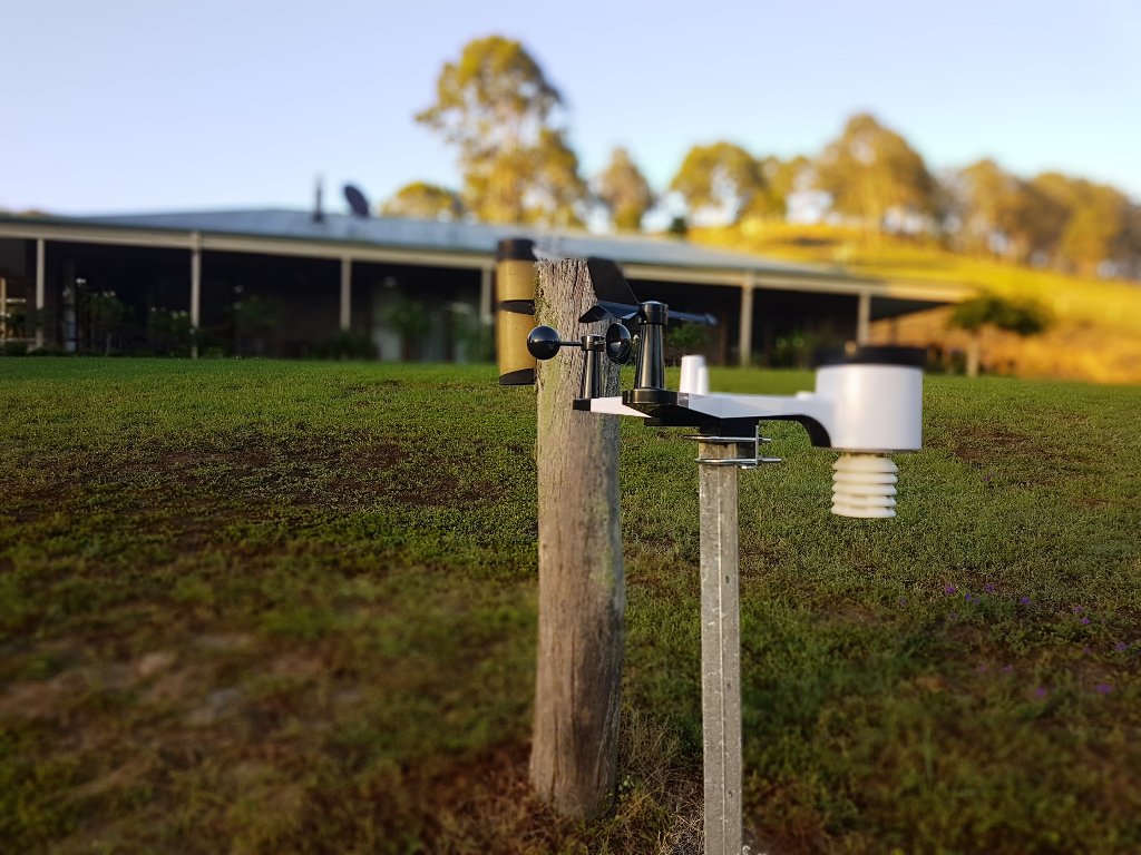

I believe the simplest way would actually be to place a quality 10cm rain gauge beside the device. Compare the two after rain and adjust the gain so they match.
Today we had the first rain here since I tweaked mine to 0.82 gain a couple of weeks ago. the HP2551 and my gauge are now in agreement. There was only 5mm of rain. Will wait for a couple more rain event before I conclude it is all fixed but it looks promising.
That's the one.
https://i.postimg.cc/9Q0LXCCF/20190113-063436.jpg
Mine is now tracking well, however the marble technique most certainly gets you within a percentage point or two.
We seem to be overthinking this. :) see https://app.box.com/s/aqr83nxeg68rpe1fpnqpvs6wch6l10xu (pdf)
Rain over night.
Gauge 22.25mm (bit hard to read to that resolution :) ), weather station 22.1 mm. Happy with that

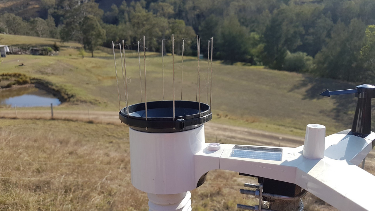

Hi Wahroonga Farm, do you find the sensor package is stable enough in high winds mounted on a star dropper or is that a maxi dropper (which certainly would be lol) I see in your photo?
I just purchased an ECOWITT WH2910C from Amazon and was going to concrete a 2" steel tube in the ground, but if a dropper works then that will be the far better/easier option.
I've been reading through this thread for the past couple of weeks and my 2 cents is anyone who is serious about rain records really needs a manual rain gauge, as these electronic ones are more for "heck it's pissing down with rain, I wonder how much rain we've had? "Without having to go outside.
Mind you the accuracy once calibrated you guys are getting is impressive.

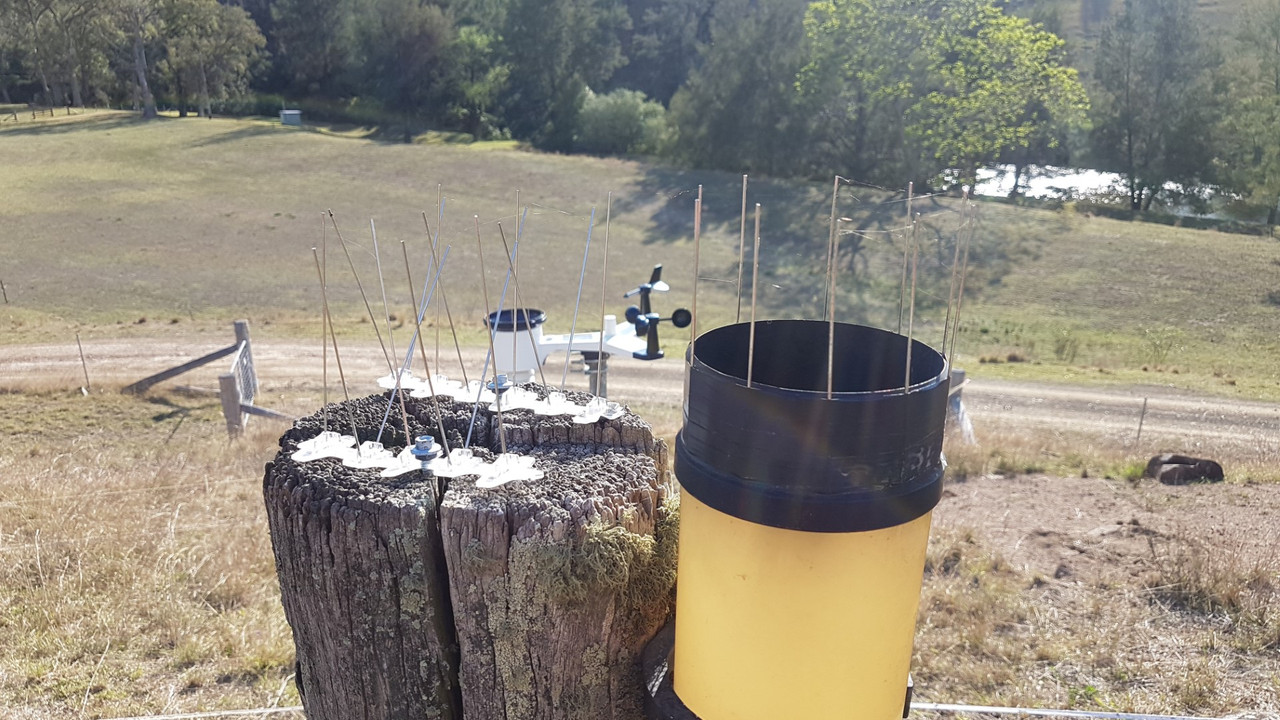

Standard dropper. However that mount and location is temporary ie the 'calibration position'.
The star picket has proven totally secure; there's not much windage load. However the problem with a dropper, is that it is not round ie the dropper orientation governs the station direction. I'd stick with the pipe. :)
It will move to the roof ... soon. :)
My annual rain data remains manual via the 10cm gauge, read at 8.00am each day.
Now that it is 'calibrated', the weather station is a fantastic back-up and provides pretty accurate daily apportionment, when away.
Yeah, I didn't think of that. I'd like to mount mine on the roof for more accurate wind readings, but I think the ambient heat in summer would be an issue. I live in the northern part of the Adelaide Hills, so summer gets pretty toasty.

Perhaps you could assist the debate by providing a 'How to calibrate a home weather station barometer'.

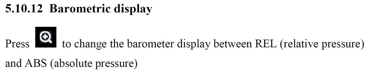

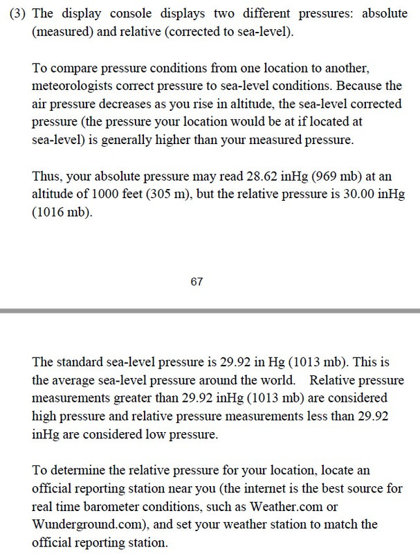

My WH2990

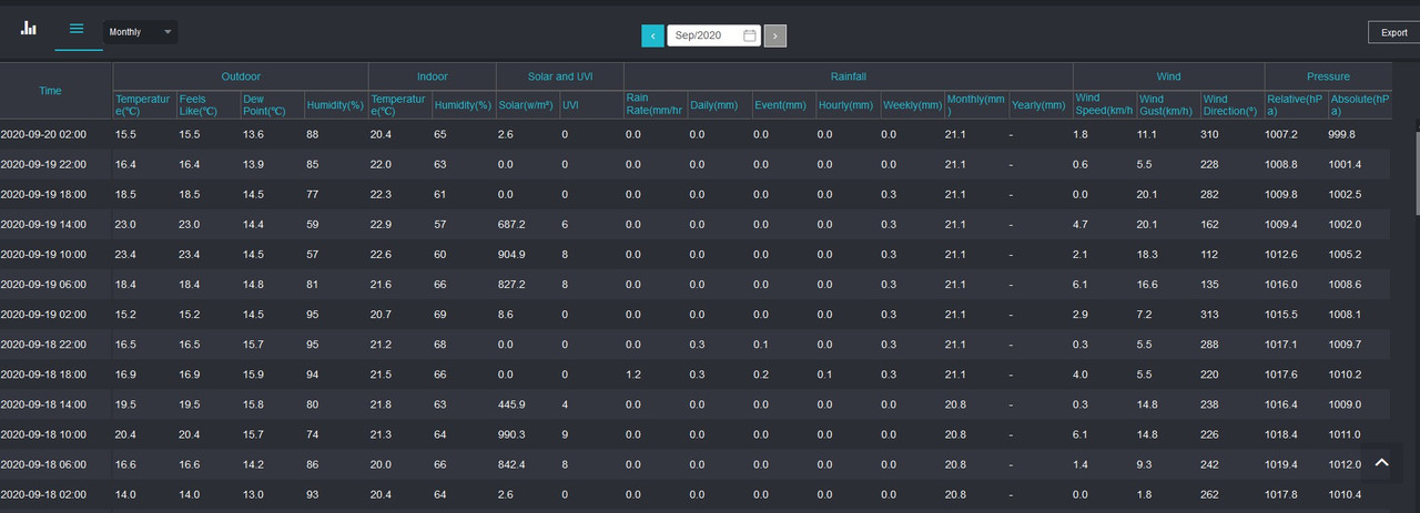

Weather stations can display either the absolute or the relative pressure.
Either option can be displayed and is available in settings.
The relative pressure should display the value at height that you have established for your station.
Just checked mine which is set at 150m. Current temperature = 19 degrees.
Absolute = 1015.6 hPa
Relative = 997.1 hPa
Difference = 18.5 hPa
As check see https://www.mide.com/pages/ai
At 19 degrees and 150m, the pressure (default) is 1013.25 hPa – 995.6028 hPa; a 17.6 hPa (difference).
That is within 1 hPa.
Near enough?
Checking the manual regarding WH2990 calibration ...
Absolute pressure offset calibrated (range +/-10hpa)
Not huge range of offset values?
From the manual, the accuracy of the barometric sensor is:
Accuracy : +/-3 hPa under 700-1100hPa
I reckon mine is prolly near enough. :)
1) Read the WX Station Instructions.
2A) If your WX Stat. has altitude adjustment, adjust to Google Maps Altitude at your place. Cross check with B)
2B) If your WX Stat. has Barometer adjustment, adjust using your closest BOM WX Stat. by clicking on your local Station on their Rain Radar Map to display the MSL Pressure that's updated every 30 minutes. You can also cross check using BOM'S Interactive Weather and Wave Forecast Maps by reading the isobar pressure directly.
3) Re check using 2B, especially in fine weather.
For every reduction of 1 Hectopascal = 8.32 Mtrs. Higher in Altitude. You can use simple math to double check both your altitude and pressure.
Sea Level Pressure = 1013.25 Hpa

Just purchased the removable bird spikes for the ecowitt 2551. Spoke to Lucy with delivery 3 to 4 weeks. Will post opinion once received and installed

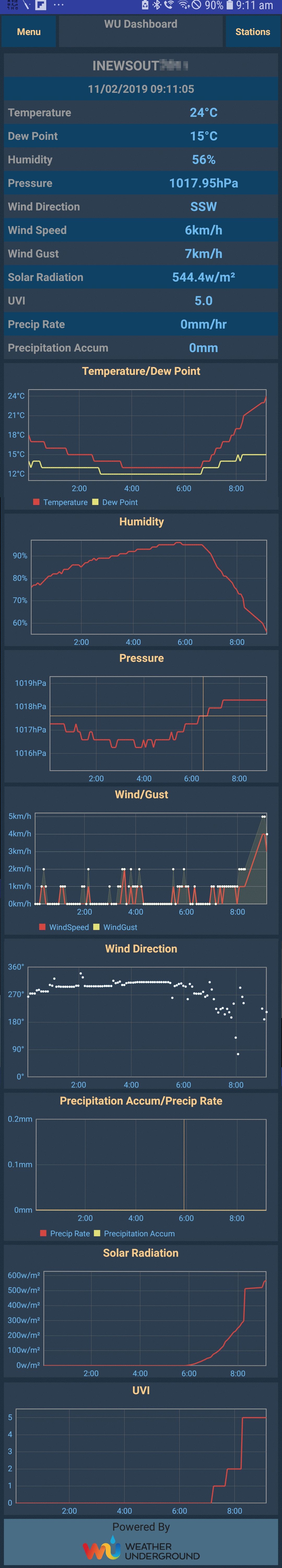

I'm within that 1017 isobar loop on Meteye.
https://i.postimg.cc/vZw0K6q
And this is me
https://i.postimg.cc/dVR5ctg
1017.25

Edit: Meteye says i'm between 1007 – 1008.
Home WX says 1005.9
Phone says 1007.3
Mainly so they can see the weather at home, while not at home, and keep track of their own data.

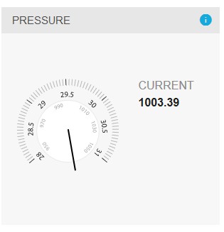

I see 2 issues on my page on mobile.

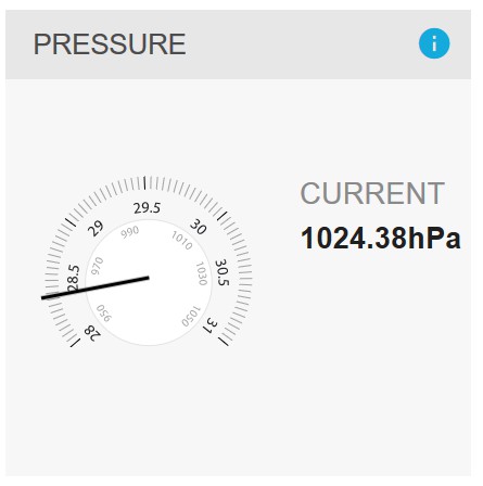

I'm at 430m which is 1414ft however it's showing at 1414m
Also the barometric pressure text is correct but the actual graphic dial is way below to the point where it's off the chart.
The desktop version on Firefox doesn't have the barmometric pressure dial. It still has the old graphs.
Mine does?

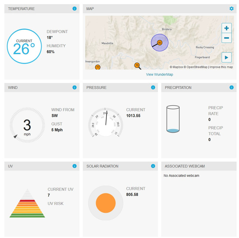

Is anyone having issues with the data on WU?
https://i.imgur.com/3bIw28P.png
The high, low and average temps are all 23c when the graph below shows the normal temp changes. Same with the wind and pressure are both showing wrong where the graphs below are right. This started yesterday.
Bugger, there's been lots of complaints over their termination of the old API on the WU forums over the last few months. Also a lot of concern now it's owned by IBM the service would be run in to the ground. Lets hope not... but might start looking at other services anyway.

Looks like they did another update on the wunderground site. Looks much better...
Thanks for the heads up, SI units again so I can now resume what used to be a fun part of my life.
Yes, despite the new clunky graphics, on a quick check all is good again.
Pity you can't kill the 100% repetitious additional graphics, as all the relevant data is displayed in the first window?
https://i.postimg.cc/k5sJGVS
https://i.postimg.cc/x80FCCK
The Information button on the additional graphics is ... interesting. :)
It's a step in the right direction. Would like to see values to 1 decimal like it use to be. The graphs suck that they are only in rounded degrees.
I agree with all the stupid big boxes. That's useless and repetitive. My pressure box graph is wrong. It's currently 1024.72hPa here at the moment, but the needle is pointing towards 970...
Woops :)
https://i.postimg.cc/PqfczH2
Yeah, it's certainly better, but I need decimals back, too! Part of the fun is watching heat records get broken in summer, even it's only by .1 of a degree.
If they are only going to show 5 minute rounded data then that is all the data I will be sending them. They say they are fixing it but if they don't then I will be throwing together some python to pass the data through to return the favour.

Looks like they fixed this. Seems to be ok now i think...
Not for me at this time.
Mine is out by roughly 40 also.
It’s also saying my wind is at 314km/h atm.
Edit: turns out the wind is 3, gust is 4. Surely they can display it better than 3|4
This is how mines been displaying since they "upgraded" it
https://i.imgur.com/fylSbW5.png
According to them, it's 1060 at my house!
And I want my decimals back. Pretty useless without them. :/

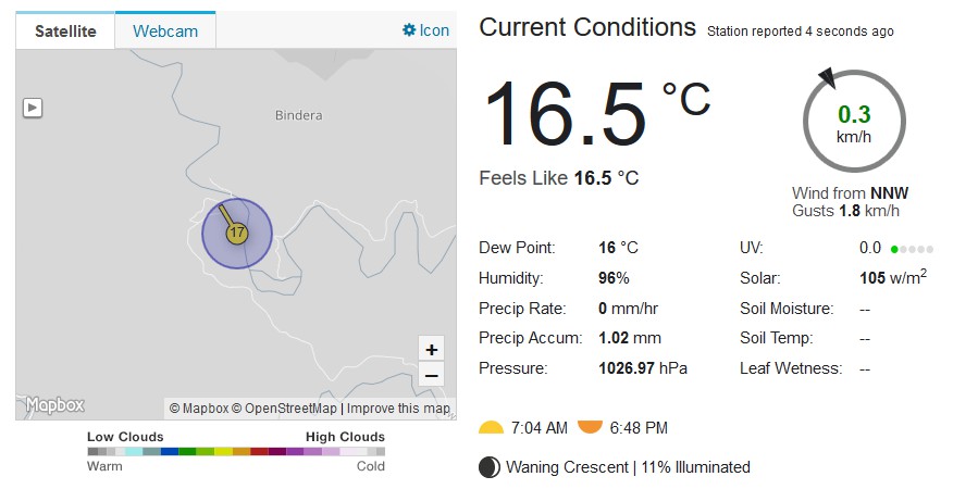

PanTech WH2950 / Weather Observations Website
The wind direction published directly via WS View to WOW is 180 degrees out even though I have calibrated weather station and it displays correctly on console.
Any ideas? Thinking I'm going to have to intercept / adjust / publish using weewx.

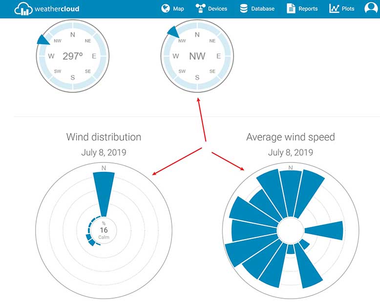

For anyone with an Ecowitt 2551 there is a new firmware out that is worth upgrading to.
It Adds www.ecowitt.net support if Wunderground had been getting you down.
Adds support to upload to user customized website. So you can send your data anywhere.
Adds average wind direction to Weathercloud which means the Wind scatter roses now work. https://i.postimg.cc/vBmWdXQH/windscatter1.jpg
http://www.ecowitt.com/upfile/201906/user_V1.4.6.zip
After installing the firmware you also need to update the Easyweather WiFi software on the WS to v1.4.0 as well using the Easyweather phone app.

Don't you just love the multiple page loads, and totally superfluous gratuitous graphical elements?
I'm trying to get my WS sending to my own website to save its data, to display it how I want. Haven't yet succeeded in receiving any data from it. If/when I do, I'll post info here.
My WS is at https://www.wunderground.com/dashboard/pws/IADELA78
First it displays Imperial units, then metric. About three slow page loads. Awful.
Don't forget the loss in detail in the graphs. Looks like half hour intervals instead of every minute.

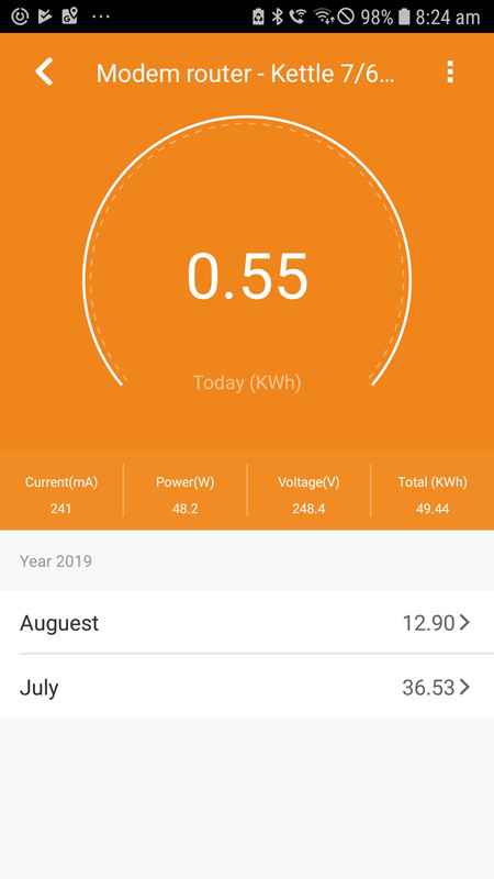

The property is off grid and only has satellite internet
The biggest problem here is leaving internet on and the fairly hefty 24 hour load of the SM modem + your router etc.
This is probably not that relevant as I run two VoiP service plus my 2-way and wifi to my solar relay from the same power source as the SM internet.
This lot draws 65W or ~1.5kWh per day. It adds up. :)
I unplugged all but the router and SM Modem and it fell to 48.2W or ~ 1.2kWh per day. The SM modem is the power hungry device.
Note: I am using a Medion Smart Plug to measure (Aldi).
https://i.postimg.cc/DzgDyLP

I just had my WH2950 temperature drop from about 6c to -40.0c in a few seconds at about 2am this morning. Ditto humidity from 82% to 10%. My other Oregon sensors say 6c and 85%.
See https://www.wunderground.com/dashboard/pws/IDODGESF5. I tried recalibration but only managed to get to -35.0c
I have tried finding any similar issue online but can't see anything. Has anyone experienced or know of this issue? My WH2950 was bought in February and I had sealed all the screw holes etc, but I guess water may have got in somewhere.

Is this a WU rendering issue, or is it supposed to indicate a recent average of wind direction?

Regarding that I thought I might mention that I eventually got my WH2900 station to match my trusted 5" diameter rural rain gauge that is located only 4 meters from it quite repeatably and within a couple of % either way.
The rain calibration multiplier number I arrived at via trial and error over the last 9 months is, '85'.
What did other users work out ?
Pantech WH2900
I was happy with 80 for mine.
The bucket accuracy varies between light dizzle and heavy rain, so it can never be perfect.
We tend more to 'heavy rain' for the bulk of our overhead precipitation, hence my setting.
I compiled this summary based on the flurry of rain gauge calibration activity some time back.
Nice.
Good that mine is also in the 80's, does give some confidence if others want to try around that mark first go.

The new bird spikes are very interesting
https://www.ebay.
https://i.postimg.cc/y62MDwK
And IMHO essential; depending on your local bird population.
I have retrofitted both my manual rain gauge and my Pantech 2950, with stainless wire bird spikes and a zip tie. Prolly should add a bit of silicon to ensure long term security,
https://i.postimg.cc/3wj6VR0X/20190928-073746-Large.jpg
https://i.postimg.cc/C1m2MQNd/20190928-073730-Large.jpg
Bit crude ... but entirely effective. The proximity of spikes will depend on the size of the offending flying critters.
Without 'protection' ... 3mm rain and 2mm ... bird poops. :)
I hate to admit, but before we went cat free, it was not a problem.
Encouraging a healthy bird population is very satisfying; although we do miss puss.

you can use the WS Iview app, Apple or Android, on your mobile to view each station.
The weather station can be set up in Weather Underground with an ID for each station. In the WS Iview app just enter each station ID and view individual info.
Family farm, spread over 3 properties, 1 house on each property (all properties within 10 mins drive of each other)
-Want to have 1 affordable wifi weather station on top of each one, with the data available for all 2 or 3 weather stations available via mobile app for about 4 separate users
If each farm house has reliable internet access then any of the wifi weather stations will do the job perfectly.
Once established on weather underground (or similar), the station data is viewable on computers and smart phones with internet access.
Typical smart phone scrolling view.

"You can only access up to 100m transmission range or transmission distance in open field: 330 feet"
Still waiting for feedback from the vendor themselves, but looks like there's some great options out there! We also suffer slightly incompatible weather reports from the BOM due to weather stations being a little too far away
That is the absolute LoS range of the wireless link between the outdoor unit and the indoor display. This wireless link is 433Mhz or so from memory?
The indoor display in turn communicates with your router via Wifi (2400Mhz) and then it's ... off to the 'cloud', once you set that bit up with a provider (free).
For my money, the only sensors that may require some calibration are:
pressure ie localise for height etc. But how much concern is this?
rain gauge. Given the experience here, the rain gauge may over record by 20% or more.
My WH2900 finally got a calibration today – my standard metal gauge measured 18.4mm and my WS measured 27.07.
Closest BOM measured 20mm
I adjusted negative 70 and we'll see how the next rain event goes.

Anyone using the bird spikes on the Pantech 2900. Did you silicone the ring on to keep it in place. Have the station setup temporarily on the fence to test and have noticed the ring keeps dislodging and dropping down, suspect birds may be attempting to land and knock it out of place. It's on as tight as I can get it but it stills moves.

I have a Pantech WH2900 that I've had up and running exactly 2 weeks today ($151.08 delivered from Flora Livings with ebay 20% off).
I live in the Encounter Lakes area of Victor Harbor, SA which for all intent and purposes is at sea level (or 2 metre altitude according to Google) so I set the Relative Pressure on my device accordingly using the data from an official BOM Station at Mundoo Channel on Hindmarsh Island which is also at sea level and about 25 Km away as the crow flies.
In the 2 weeks my unit has been running it always tracks within Half a Hpa of the official BOM site which is close enough for me.
My question: The absolute pressure on my unit is always about 2 Hpa higher than the relative, correct me if I'm wrong but to to my understanding, at sea level, relative and absolute should read the same?
I read somewhere that Absolute Pressure on the units is set at manufacturing time using precise instruments and shouldn't be meddled with, so in my case who's right and who's wrong?
Can someone shed some light on this or am I completely misunderstanding the way the 2 pressures interact with each other?

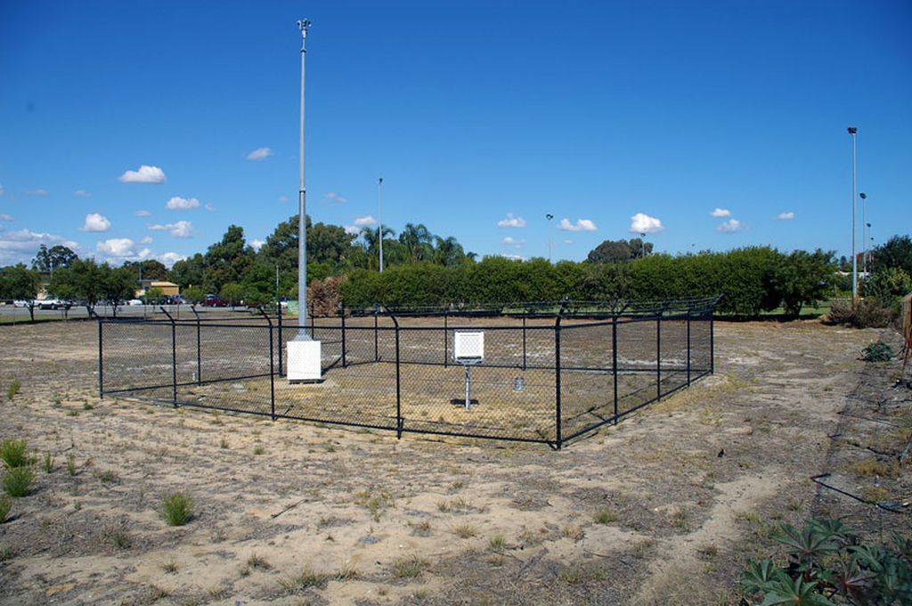

Unlike Bom which most people go by the weather on the news that is reported as being from the head office and they think that applies to where they actually live when they can be 50 kms from there having access to your own station is more accurate for your area.
Hereyago.
http://www.bom.gov.au/sa/observations/saall.shtml
Pick a station that's close to you for the most accurate weather in your area. Weighup whatever WU station you are looking at in relation to the BOM site for accuracy.

West Terrace is Bom's new headquarters on the edge of CBD & temperatures there are lower than their previous HQ Kent Town which is a more built-up area earlier this year Bom gave out a new record for Adelaide which was a couple of degrees lower than records for Kent Town .
There is a 4C difference between West Terrace & Kent Town 4.5km between them now & 7C between Kent Town & Adelaide airport
Weather is very different suburb to suburb unfortunately when Bom forecasts are on the news the forecast is actually for West Terrace not all the suburbs . People take Adelaide forecast as being the whole city & metro Adelaide . In winter people that live 60kms away will change their plans if it is forecast to rain & they were going to be involved in outdoor activities . I used to have people that wanted to go back home when they got to my place if it was raining & we were going to Mallala Motorsports Park the crazy thing is being 60kms away it is rarely raining there when pouring in my suburb.
Even within the same suburb. On WU, there are another 5 stations within 1.5kms of mine. The readings can vary a bit here. Temps can be 1-2 degrees different, but it's also handy, as you can see rainfall and wind differences. There is an official BOM station about 1.8kms in a straight line from my house. It's handy, but its readings can be very different due to it being in the middle of an airport, so temps, wind, etc can vary. It's good to use as a guide.

2900 users, are the bird spikes really needed?
It probably depends on your locale and deployment
I found that birds loved crapping in mine, so diy'd with stainless wire, cable tie and dabs of silicon.
Bird poo really gums up the bucket guage.
So in a nutshell, I reckon spikes are a sound investment. :)
for 2900 users, are the bird spikes really needed?
I haven't bothered with them but as Wahroonga Farm says probably depends on locale.
I've only had mine up for a fortnight so I might change my mind later on although an old Holman that this one replaced was up for about 11 months with no bird issues.
I haven't bothered with mine. I've never seen a bird near it.
One issue I did have was that the funnel for the rain gauge would blow off in the wind. Fixed that in the first few days with some gaffa tape and hasn't moved since.
Prolly has a fair bit to do with ... pussy cats?
Whilst I've always apreciated the company of puss, they are just sooo deadly on birdlife.
After the last puss went to God, we decided no more.
Now a plethora of small birds and the absolute necessity of bird spikes. We are rural.

I'm setting up my new Ecowitt station and have noticed that the Barometer reading seems lower than it should be. It is currently reading as 993.1, however when I look at Weatherzone the reading on there is 1018.1 for my closest town that Weatherzone gets its data form, albeit a different topography (hilly and a valley). We are located just over a peak of the hill we are on on the south eastern side.
Our elevation is 241m.
Is the Ecowitt Barmometer really that far out? Or is my station faulty? Or does it need a set time to adjust itself?
How do I check it while not having another barometer?
Is it better to use ABS or REL?
Are phone barometers any good to use as a comparison?
EDIT: My internal sensor in another room is reading the lower 993 also, which has been on for 24 hours

Ok so that ios the same as what Weatherzone is saying, so my station is either not working properly or I just need to adjust it via calibration from 993 to 1017, which I have now done.
If your phone is anywhere near your weather station, I'd trust it more than weatherzone
I've tested 4 apps, two report higher than the 1017, whilst two report the same 993 values
Plus as I said before my internal sensor is also reading 993

I suspect that you are getting tangled up in the difference between MSLP and absolute pressure.
Your phone will generally read absolute, unless an altitude offset is provided.
BOM and most other sites correct the stations altitude and record MSLP.
I am at 230m. My nearest station is at Taree, which is some distance.
My phones absolute pressue is 980mBar
My phones MSLP is 1006mBar (230m offset) ... using Android App Barometer Reborn.
https://i.imgur.com/j18hU7d.jpg
My Weather station (adjusted for MSLP by elevation input) is 1005.6mBar.
Taree shows 1006.5mBar.
IMO weather station pressure guages are pretty reliable. :)
Maybe I am ... how do I check? In my stations settings the barometer settings are set to hpa.
If I do not calibrate the station is reporting in the 990's (hpa), on two phone apps it says the same 990s, on my internal sensor in another room it has the 990s number as well.
However if I look at the Bom site, two other phone apps plus other stations closest to me on weathercloud the hpa is around the 1015 (as of now).
What am I misreading?

Out of box, installed 24 hours now, I have only adjusted the date/time, latitude/longitude and the barometer
There should be a setting for your locations altitude? But no ... you need to calibrate both ABS and REL.
You can change the view of Absolute or Relative (MSLP)
https://i.postimg.cc/k5wjJv1
You can calibrate both ABS and REL individually.
https://i.postimg.cc/zfMxHGN
How to
https://i.postimg.cc/vTmDRb1
About ABS and REL
https://i.postimg.cc/HnPndR5
How to

How do I reset my stations ABS not calibrated. I can't reset to 00000, so how can I get it to set its own uncalibrated value, which was in the 990s yesterday until I set what I though was the correct pressure.
It would have arrived factory calibrated.
You will now have to set it to the ABS of your location. In the abscence of a laboratory barometer ...
... use your phone (reading ABS) or other household barometer.

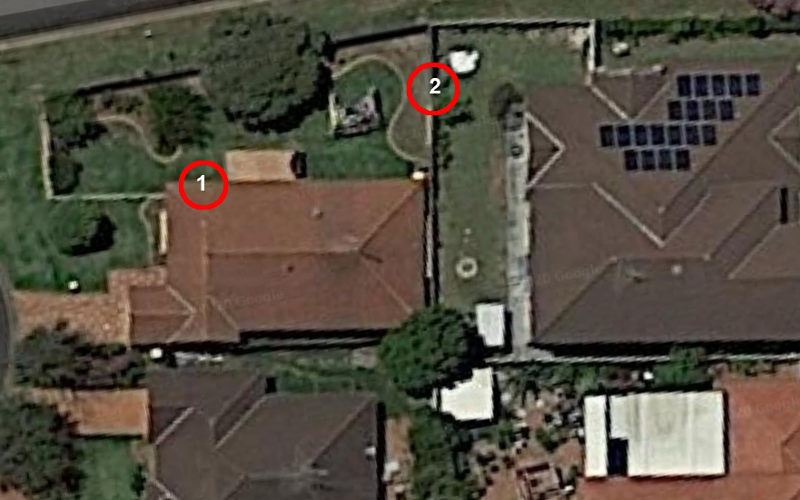

Hi all!
Looking at a Pantech and was hoping for some advice as to where i should install it? Does it go in full sun?
I can mount it on the side of an existing tv antenna pole but it will be in close proximity to the metal roof...
Alternatively i could install a new pole off the brickwork off the side of the house. How much height would i need from the metal roof?
Also what's the difference between the Pantech WH-2950 and the HP 2550? Any opinions would be great for a weather newbie
That is the objective. They seem to handle it OK.
- Clear solar radiation measurements ie full sun
- Clear wind measurements ie no obstructions
- Clear full sun temperature measurement . The temp gauge is suitably 'bee box' housed to measure ambient air temp.

4.2 Site Survey – Perform a site survey before installing the weather station. Consider the following:
1. You must clean the rain gauge every few months and change the rechargeable batteries every 2-3 years. Provide easy access to the weather station.
Good tip as the bucket assembly fill with dust and mud which may seize it entirely. Hold the bucket steady and flush with clean water hose etc
2. Avoid radiant heat transfer from buildings and structures. In general, install the sensor array at least 5’ from any building, structure, ground, or roof top.
3. Avoid wind and rain obstructions. The rule of thumb is to install the sensor array at least four times the distance of the height of the tallest obstruction. For example, if the building is 20’ tall, and the mounting pole is 6’ tall, install 4 x (20 – 6)’ = 56’ away.
4. Wireless Range. The radio communication between receiver and transmitter in an open field can reach a distance of up to 330 feet, providing there are no interfering obstacles such as buildings, trees, vehicles, high voltage lines. Wireless signals will not penetrate metal buildings. Under most conditions, the maximum wireless range is 100’.
5. Radio interference such as PCs, radios or TV sets can, in the worst case, entirely cut off radio communication. Please take this into consideration when choosing console or mounting locations. Make sure your display console is at least five feet away from any electronic device to avoid interference.

IMO the bird spike ring is a valuable addition.

Another thing I noticed with WU site is when the page loads up initially in Farenheit it actually shows the apparent temp but when it switches to Celcius and fully loads the apparent temp is always identical to the actual temp.
Does anyone else notice this?
Yes the other thing i noticed when the page loads for example right now it says Temp 77.0 Feels Like 78.4 and when it flicks to Celsius it says Temp 25.0c and Feels Like 25.0c
How can the temp and feels like be identical in Celsius but different in Fahrenheit. 78.4f is 25.7c and not 25.0c
At a guess, it is related to the fact that when they cut over to a new platform, the API stopped providing temperature in Celsius to one decimal place, and is instead rounded down to the nearest degree.
It wouldn't surprise me if the same clumsy code is manifesting itself here.

My WH2900 has arrived and quite excited setting it up. Does the indoor temperature & humidity from the console go anywhere, ie I'd like to read it from either my HomeAssistant screen or Wunderground page?

I went yesterday to Bunnings and bought a Holman manual cylinder rain gauge and put it up at midnight to see what it read this morning.
Holman reading 20mm and the Pantech is reading 25mm. But the the local BoM (about 5km as the crow flies) is reading 24.6mm so that screwed me. Weather stations around me are reading anything from 11mm to 45mm!!!
Will have to do some more readings....

For those with the 2900, does the external power cord sit flush on the rear of the indoor unit so if wall mounted it will sit flush?
Regards,
Steve
From memory it sticks out. I'll check when I get home.
Here you go.
https://i.postimg.cc/vZr8DQ9p/WH-2900-power.jpg
Apologies its a bit fuzzy but the short answer; good to go. :)
Thanks mate. Seems my memory is hazy haha. Looks like it's even got mounting points ready to go too which is pretty cool.
Yes it's well done.
What I didn't realise (until I took the snapshot) was all the handy basic info on the rear of the unit including QR codes. :)
All obviously vital to set-up & programming then ‽ :-)

Just where to mount your AWS is a bit of a conundrum.
BOM sites record temp at around 1m above ground level, anemometer/ direction often on a mast and rainfall almost at ground level.
So ... roof mounting your weather station is likely to skew temperature, but wind strength and direction will be more accurate.
It likely skews rainfall due to wind velocity at height and ultimately we are measuring 'what falls on the ground'.
https://i.postimg.cc/qBzQHQxg/perth-mt-lawley-9225.jpg
Mt Lawley, Perth

Hi all,
I'm after a bit more advice. Attached is a link to a satellite shot of my house. I am thinking of mounting in one of two locations. Mine is the house on the left.
Location 1 would be on a fascia mount, appr 1.5-1.8 mtrs tall.
Location 2 would be on a mast attached to the fence, not sure how high.
Location 1 would probably be the easiest for me.
The tree at the top is a Melaluca about 10 mtrs tall. The house behind is double story, mine is single. Location 1 is about 20 mtrs from the house behind, location 2 is about 5.5 mtrs.
There are trees across the road, probably 20 mtrs tall and appr 20 mtrs away.
The house next to me in the same street is single story.
North is at the top of the image.
https://i.postimg.cc/9MhyKrrK/Aerial.jpg
TIA
Steve

Optimal AWS mounting always describes distance from 'obstacles' in multiples of the AWS height.
In this consideration location 1 is likely the better of the two.
Thanks, that is about what I figured.

Thought I'd share the figures for the 9 days of rain we had after mounting the Nylex
Manual Nylex
119 115.5
23 21.7
109 106.5
53 48
21 20.5
52 52.2
173 168.5
15 14.2
2.5 2.5
Total
567.5 549.6
17.9 mm difference, which by my sums, works out to be ~3.1% discrepancy?
& 10.5 mm of that is over 3 days when it absolutely pelted down.
Anything under 1 mm, I'd call identical, as it depends on how much is still sitting in the bucket, but hasn't tipped, & also the thickness of the water-line in the manual gauge – do you read the top of the line, the bottom, or the middle? :-)
So, yes, we'll keep the manual gauge for proper accuracy, but if it rains while we're away, I'm perfectly happy to say that whatever figure the Nylex gives is good enough!

Have provided some options at https://postimg.cc/sGgSNXNM. I was thinking the red dot.
Agreed green dot is best as it has the most height.
I'd go the green dot.
Thanks. Thinking about it though it is the most difficult location to install. Maybe the yellow dot might be easiest and second best spot. Typically wind/weather comes from the front left corner of the building https://postimg.cc/sGgSNXNM, so less interference for that direction. Would be nice to have up higher but not too keen on getting up there.
I used the 1400mm from Bunnings
Sounds like a good plan. Cheers
You'll notice the bottom section on the mast isn't pushed all the way home. Left it so it would come off easier and spray it with Lanox each time to keep it from binding. If you push it all the way good luck getting it out again. ;
I have one of these, installed it this week. Still got to put the PWS on it. If you look carefully, all the sections have a small nib that stops the sections from being pushed all the way home. I sprayed mine with WD40 initially to keep it from jamming, but bought some WD40 silicon spray for long term usage.
Leveled the bottom section with a spirit level before bolting it in. it was slightly out, but by the time I fitted the next two sections the top one was level.

Trying to configure WSView but my Pantech HP2550 st up doesn't match any of these https://postimg.cc/t7Lk4CjG
Perhaps the easiest way on your own website would be to add a link to your station. From what I have gathered, it can be done, but not necessarily easy.
Yeah was hoping there would be an easier way without having to be an expert coder!
If you bought it form Flora Livings, ask them.
It's possible you are using the wrong app. The manual specifies which apps to use. If you don't have a manual, go here.

Also, I have noticed most people mount it on the house. I am actually thinking of mounting it on the side fence about 20-30m away from the house, any reason for not doing it?
You need to make sure it is higher than surrounding buildings and a long distance away from your neighbour to get accurate wind readings as the wind will bounce around between properties. Also a building close buy will skew the rainfall data.
Mounted immediately above the ridge line will give you an increased reading as wind pushes up the slope of the roof.
BoM have a standard for their setups:
Anemometers starting page 21.
Ideally anemometers should be exposed over level terrain at a standard height of 10 metres above the mean ground level at locations completely free of all obstructions to the air flow
A table on page 29 has the relevant information for heights and distances from obstructions.
Probably you'll wind up somewhat simpler than the BoM ideal but hopefully slightly better than the very basic info from wunderground.
... and rainfall capture begins at page 35 ... if you want to open a real can of worms. :)
P. 40 ...
For fully instrumented stations with an instrument enclosure, the rain gauge shall be positioned as per the standard Bureau instrument lay out, with the provisions that follow also being met.
The height of the gauge orifice should be 300mm above the ground. Where local effects indicate this height is totally impractical and all avenues to find a site with a suitable exposure have been exhausted, heights of between 300mm and 1 metre may also be accepted, provided the reasons for the departure from the standard exposure are clearly identified on the station history file.
bla bla bla.
But the key here is that the location for wind measurement and that for rain fall measurement; are entirely different.
So for our little all in one AWS, compromises must be made.

What desktop s/w is available to record data from my WS? I am looking at Cumulus but it is old and difficult to set up. Ecowitt server is great but I would like a package that gives me a radar plot of wind strength and direction over time. I know I could make a plot using the excel data from Ecowitt but that is not that easy to do.
On another note, I notice the data on Wunderground and Weather cloud differs from what is displayed on my console, even if I match times. Ecowitt is slightly different, but much closer to what I see on the console.

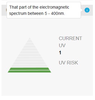

Did anybody's weather station record a huge spike in solar activity today? Mine hit over 1700w/m2 with a UV of 14 at around 10 minutes to midday (AWST) and then 2369 w/m2 about half an hour later.
I've only had my weather station for a couple of months so haven't got a lot of historical data to compare. But these readings seem abnormally high when you consider that it is a cloudy, humid day in Perth and its currently giving a reading of about 300w/m2.
Could it be a fault with the weather station? Solar flare? Any suggestions welcome.
Cumulus is old but there's a new, current version – CumulusMX. It's regularly updated and has a strong community
Nope. Over in the East though.
Topped 400 today due to overcast conditions from mid morning.
As mentioned previously, we got one of these https://www.bunnings.com.au/n
Been happy with it, but then it didn't register yesterday's 6mm of rain at all? :-(
Had noticed comments from others re dirt in the funnel & so on, but on checking it this morning, I've found another problem ... bloody Green Ants have decided that it's a lovely sheltered spot to start building a nest! :-(
When I took the funnel off, they started coming out from under the bucket, but I'm not sure if they've gone into the bottom section of the unit, where the thermometer is housed?
Any suggestions on how to clean things out?
I've sprayed around the body with surface spray which seems like it's possibly cleared them out, but I'm a bit reluctant to hose it out or similar, as not sure what the water would do?
Any thoughts?
... can be aggressive on some plastics ... in my expereince.
Washing in fresh water might be the best?
Obviously, remove the batteries first!, but then it should be OK?
Water's not going to damage anything internal?
I'm not suggesting dunking electronics in water. :)
Certainly battery / power disconnected.
However a gentle blow dry and a day or two in a warm environment would dry it out should the worst happen.
Bit like treatment for phones that have been dunked?

Hi folks
Help! – I have a Pantech WH2900 that goes very nicely thank you BUT... the clock display is wrong. It is two hours behind and if I set the clock to the right time within a minute or two it reverts to two hours behind (likely timezone setting is wrong)
Going into settings it skips over both Day savings and the ability to enter timezone (which I assume is the issue).
Any ideas on why my settings sequence matches the manual except it misses the steps of DST and Timezone?
Very confused...
Register it with Ecowitt.net, enter your location and Ecowitt will sync it to your local timezone including DST, if applicable.
My 2900 also does not have the settings for timezone and DST but as soon as I registered it with Ecowitt the time was correct.
I'm in SA and over summer it also corrected to DST.
Thanks Wahroonga Farm – Checked (just in case) – Router time (and zone) was as it should be.
Thanks Pelican1 – I didn't need to try your resolution – I resolved the issue the old fashioned way by switching it off and on. It restarted fine with the correct time now displaying.
(OK – I had to remove batteries and power down to allow everything to clear, but all is good now)
Thank you folks and forum for your advice.

HI, just got the Pantech 2550, Just a couple of questions if thats ok
What is the best weather server to use
and
My barometric pressure reads the same for Absolute and Relative, is this correct or am I meant to set this in the calibration screen and if so how do I find out the pressures ?

Thinking about how best to mount a 2900 to the house. Im considering extending the current aerial pole which is barge mounted.
What distance should i get the unit above my ironstone metal roof to reduce temperature inaccuracy? Id like it to be at 1.5m ish for ease of install / maintenance.
Would be good if there was an inexpensive station with seperate wind and temp sensors
Any idea how to change the timezone on my WH2900? has just started to show 2 hours ahead of my zone?
see https://www.wunderground.com/pws/installation-guide
If the thermometer is placed on a roof-top, make sure it is at least 5 feet above the roof-top.
The one issue with elevated stations is that due to higher (more accurate) wind velocity, rainfall may be less accurate.
It seems to be at trade off when it comes to where to place it. I have mine on top of the roof right now but may bring it down from there and mount it closer to the ground. I want both rain and wind to be as accurate as they can be but i'll setting for rain right now so i'll move it closer to the ground.
Higher or lower? Mine is located about 3m above the roof on a tv aerial pole I got from Bunnings. Works very well and sectioned so it's (relatively) easy to remove.
Readings seem accurate for all – I'm not particularly OCD about absolute accuracy though. I did adjust my rainfall calibration down slightly as it did seem to read too high. Always hard to tell compared to the BOM because rainfall can be very localised.
Hey Scythe, what pole are you using from Bunnings? Have you earthed the pole for lightning protection?
This one: https://www.bunnings.com.au/a
Added two extensions to it. Guy roped down for stability. No grounding for lightning.
On my 2900 there is no timezone option in the menu, it just synced to the correct time when I set it up and entered my location on Ecowitt.net.
I'm in SA and it also automatically adjusts for Summer Time.

Wunderground
https://i.postimg.cc/TTZ05tx
Ecowitt
https://i.postimg.cc/QxK5XrF
Heres what i get on wunderground
Vs ecowitt
I'm actually showing more on ecowitt but i swear there was more on wundergound a few nights ago.

Strangely, the weather station has also recorded 4mm of rain today — for which there has only been a lot of wind — not any rain. Which was strange. But i'm going to leave it in the current spot for a week or two, look out for anything odd and then when i take it down to inspect everything is in place and all and if need — perform any calibrations. It got me thinking. Has anyone else ever noticed any weird quirks with theirs?
How steady is the mounting pole? The wind could be causing it to move around/vibrate causing the rain bucket to tip.
Having said that, 4mm is a lot of of tips
it isn't in it's permanent location but something i've been considering for when i affix it permanently in a week or so.
In the meantime, does anyone know how to get these damn things synced with wunderground? I'm about to rip my hair out... everything is correct and data is transmitting (EcoWitt website is picking up the PanTech HP-2550 perfectly). It is just wunderground.
My ID was ISYDNE1127, i noticed 1125, 1126 were also relatively new and reporting as 'offline'. I got a little frustrated and deleted again. ID is now ISYDNE1130. Updated that and the key inside the console — no luck.
At the moment I have
Station ID: ISYDNE1130
Station Key: [exactly as provided by wunderground]
If it helps, i also don't have the wU icon it is showing in the manual appearing on the home-screen...
Edit 5:56: I think the cause is perhaps temperamental software and WU. I was heavily 'tilted' (learnt that word from my younger cousin just recently) and decided 'nope' I need to just leave it be. Hard-reset everything then leave it be for a week. I logged in *before* connecting EcoWitt or anything andd about 30 seconds after i added the new ID and key, i now have the 'WU' logo in top left.
Edit 2: I also realised the source. I have a pole affixed to a pool-fence post. As my dog is walking past she is intentionally rubbing at it and nudging it. So i know to put it on the inside of the fence. I think this might be tripping the water sensor.

I am more interested in looking at weather patterns and being able to go back over previous monthly detailed readings. Is this possible with different software
Yes WU, Ecowitt (the better IMHO) and others record your historical data 'in the cloud'.
Data is available over various periods and may be customised and exported as an .xlxs excel file.
Ecowitt Data periods
https://i.postimg.cc/Nj1W743
Ecowitt Monthly data table example
https://i.postimg.cc/4xCD9MS
Note: Ecowitt records the display panels indoor data. WU does not.

Have my station setup on ecowitt.net
Is it possible to have the map showing on the main screen like Wunderground, instead of having to select it from the menu. I find it good to compare my readings with stations around me.
